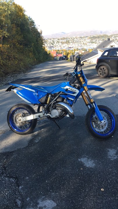

Ottarvoldjensen Posted March 26, 2018 Report Share Posted March 26, 2018 Hello there! You can delete this post if you want to since im writing in english, but i hope you guys can understand! So, i have a Tm smr 125 2007 and have had some problems with my engine. I am wondering if any of you guys know if it is hard to but a bigger tm engine in the smr 125 frame? I was thinking about a 250 or 300 cc engine. It would have been so nice to have a bigger engine that acctually works in my bike so that i can have alot more power when i ride! Thanks for your awnser! Greetings from Norway video-1522086293.mp4 Quote Link to comment Share on other sites More sharing options...
