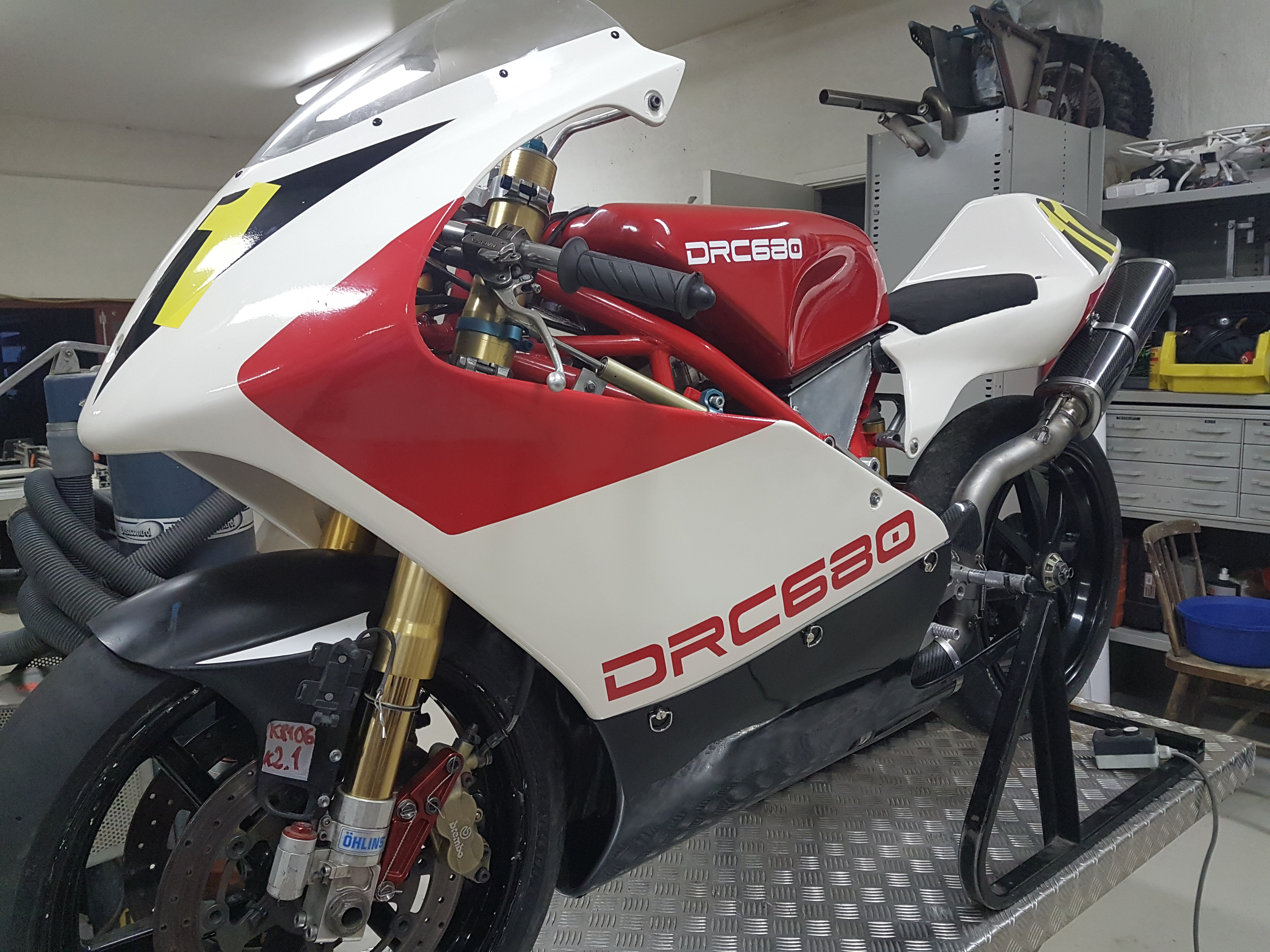

I test started the engine yesterday, after having built in a new counter balancer. The difference was huge! Vibrations were down to a minimum! On Tuesday its off to a local track, for further testing. Skickat från min SM-A310F via Tapatalk

It is necessary to mount 90WCu10 inserts to obtain the calculated imbalance. I do not know the weight after this latest upgrade. I'll have to get back to you on that matter. According to the simulations, the amplitude will be reduced by appr. a factor of 6. Skickat från min SM-A310F via Tapatalk
