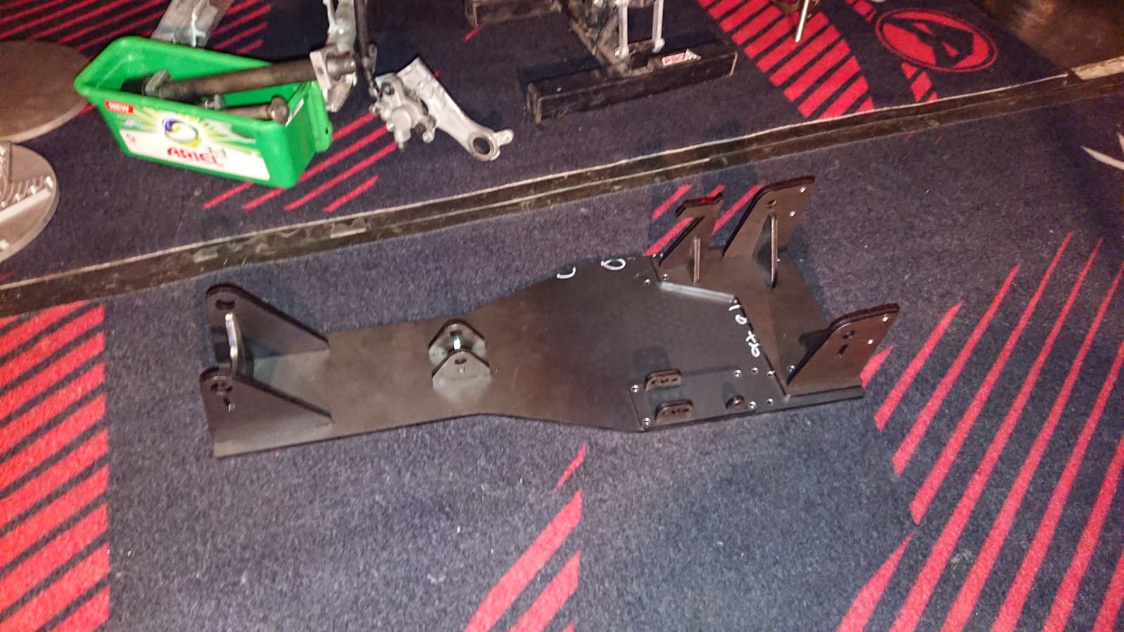

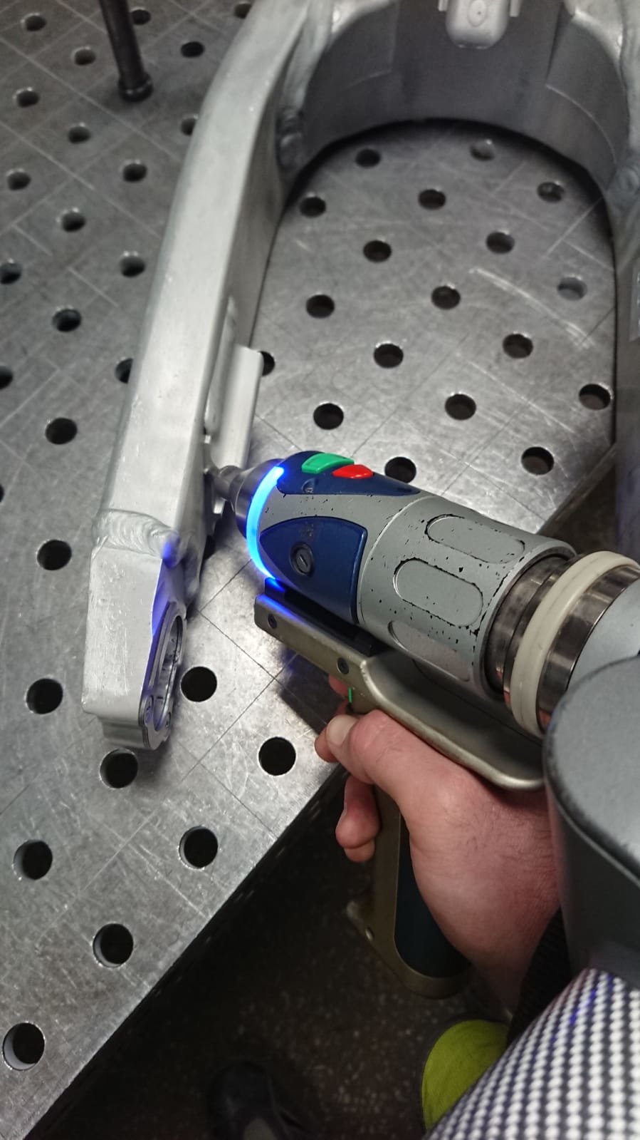

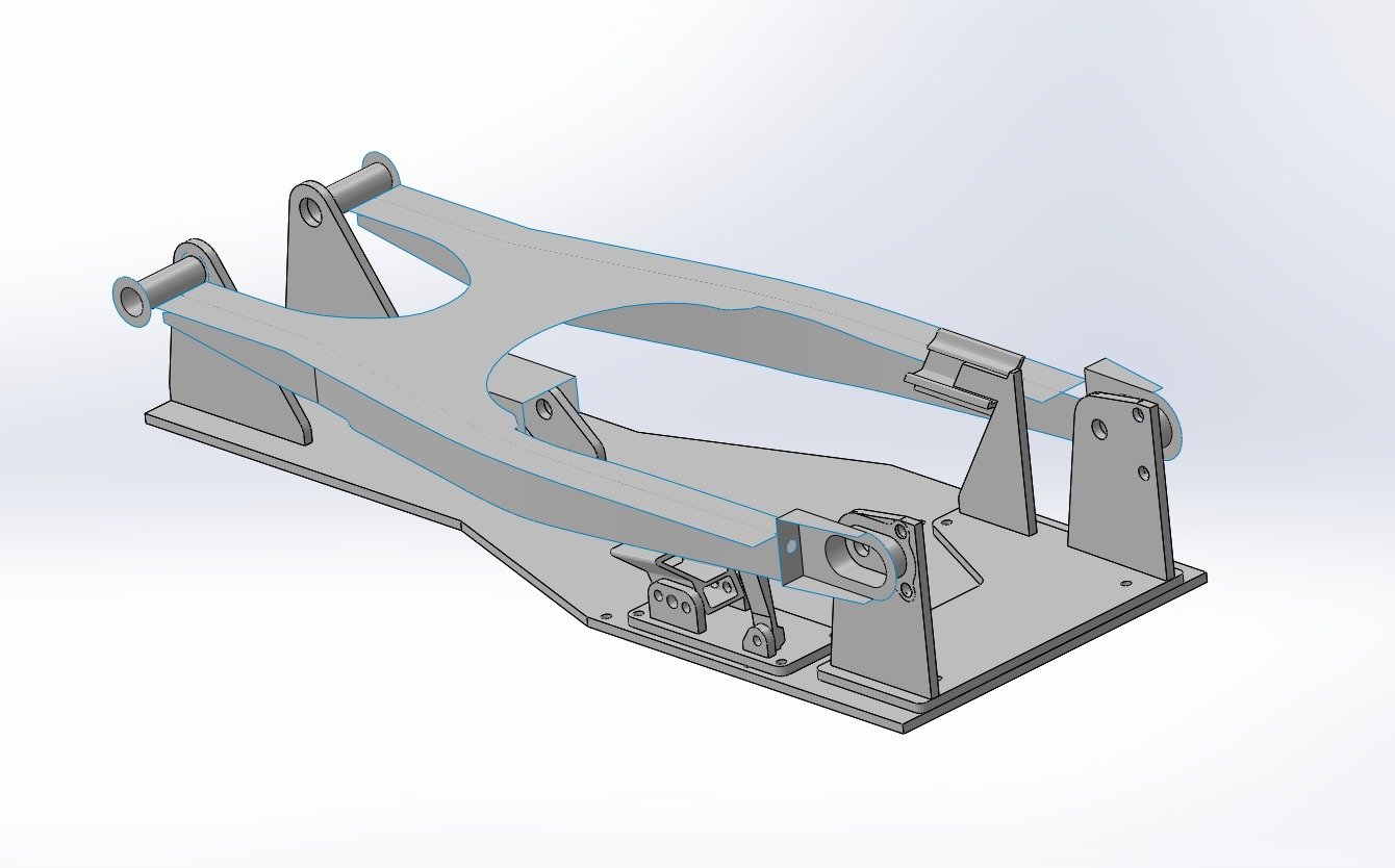

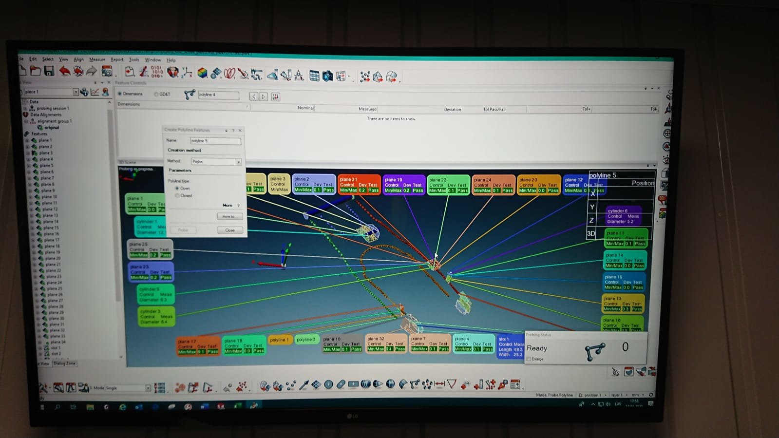

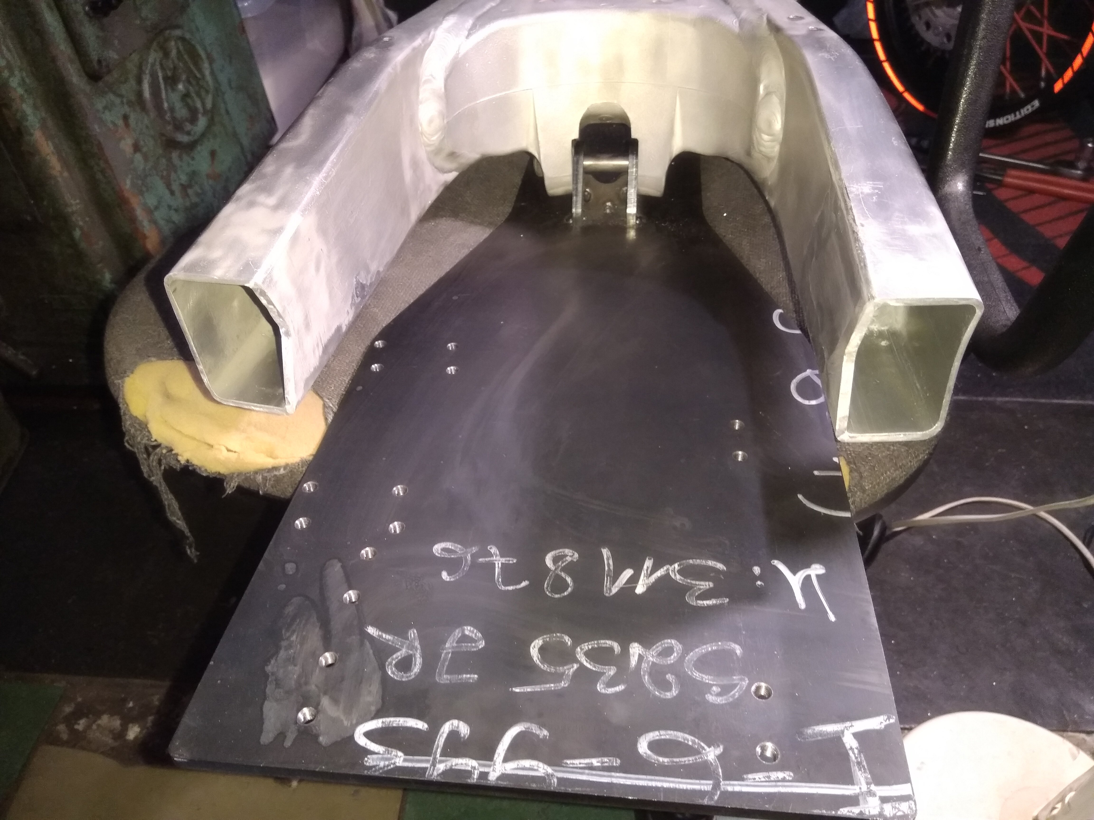

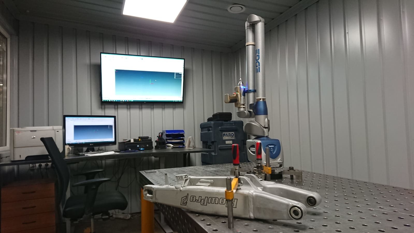

Made it last spring.
So everything is scanned and planes found to make a jig which helps to keep swing at right position.

lol God damnit Andis!
me: ok where´s my grinder and let´s cut this wide open.
you: let me set up my rocketship science lab before we proceed.
vor 12 Stunden schrieb Ben:
Andi's gonna scan his Fender only to get a Decal glued on perfectly even!!  :lol3:
Jokes aside: With this Conductor you'd be able to make a business out of this. Awesome craftmanship Mate!!! :smile_bow:
Andis you are truly THE Mad Scientist 😜
Great Work
