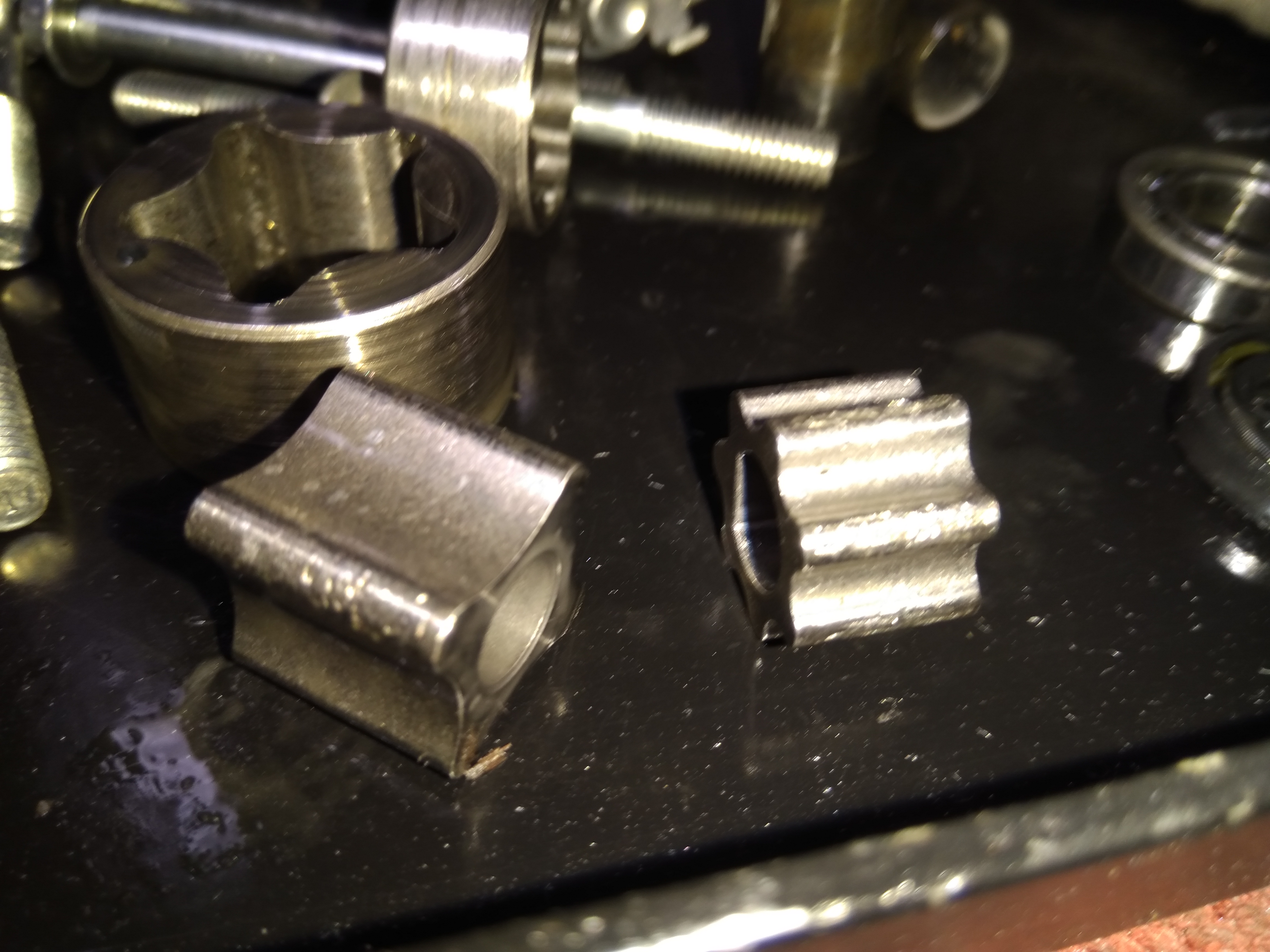

kab-pro 93 Report post Posted March 13, 2019 It is absolutely clear that the crankshaft bearings are not in order. The engine is teared down completely, next discoveries and surprises follows. First I noticed this, mist bearing position locks. It looks like both pump was something to chewed. 1 Quote Share this post Link to post Share on other sites
dr.-hasenbein 1,369 Report post Posted March 13, 2019 (edited) Hmmm... "Discovery Chanel" in real fuuuck... good idea to look a bit deeper Edited March 13, 2019 by dr.-hasenbein Quote Share this post Link to post Share on other sites

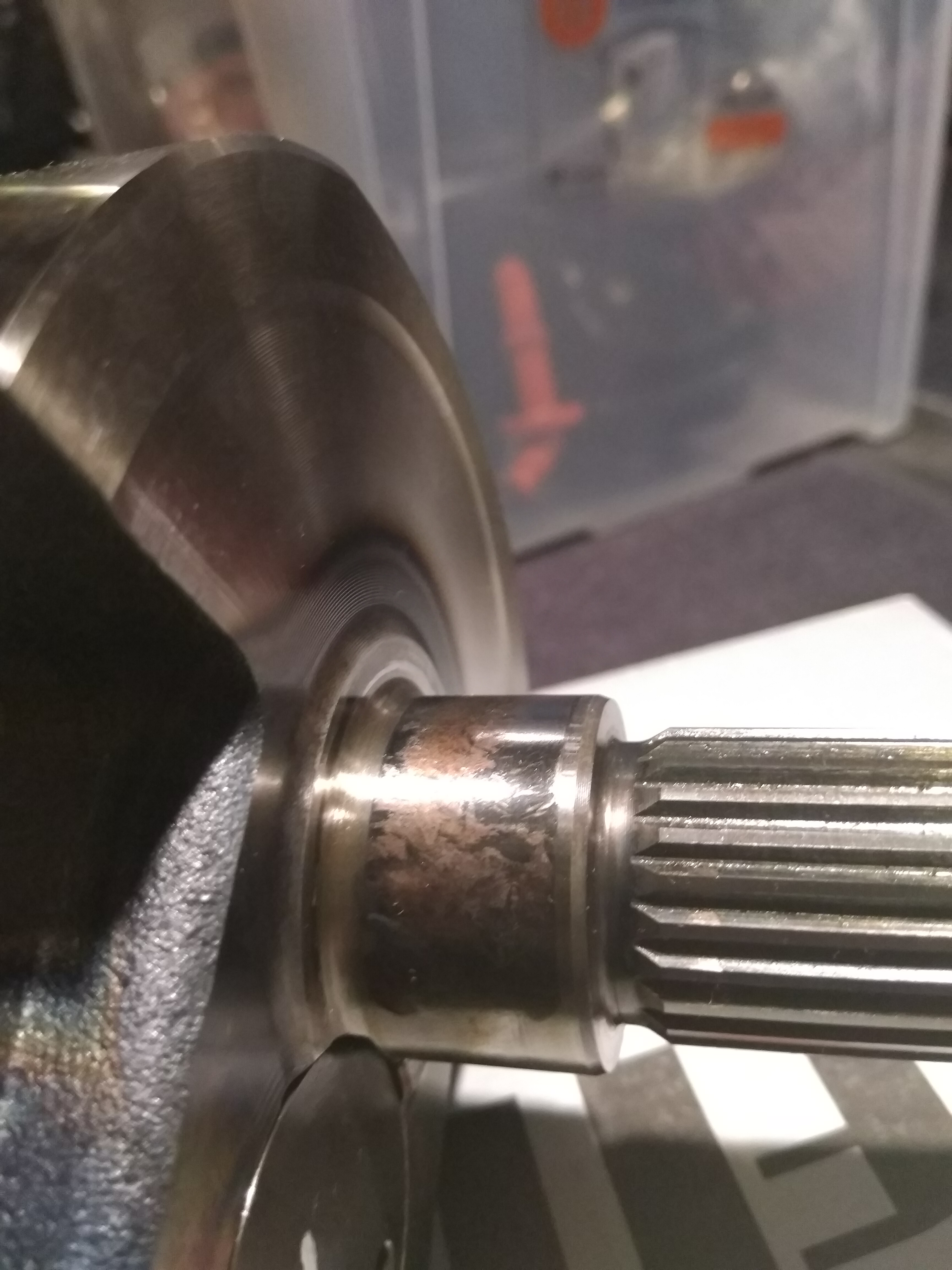

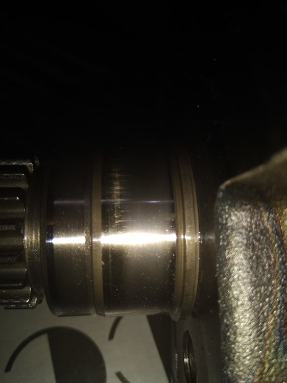

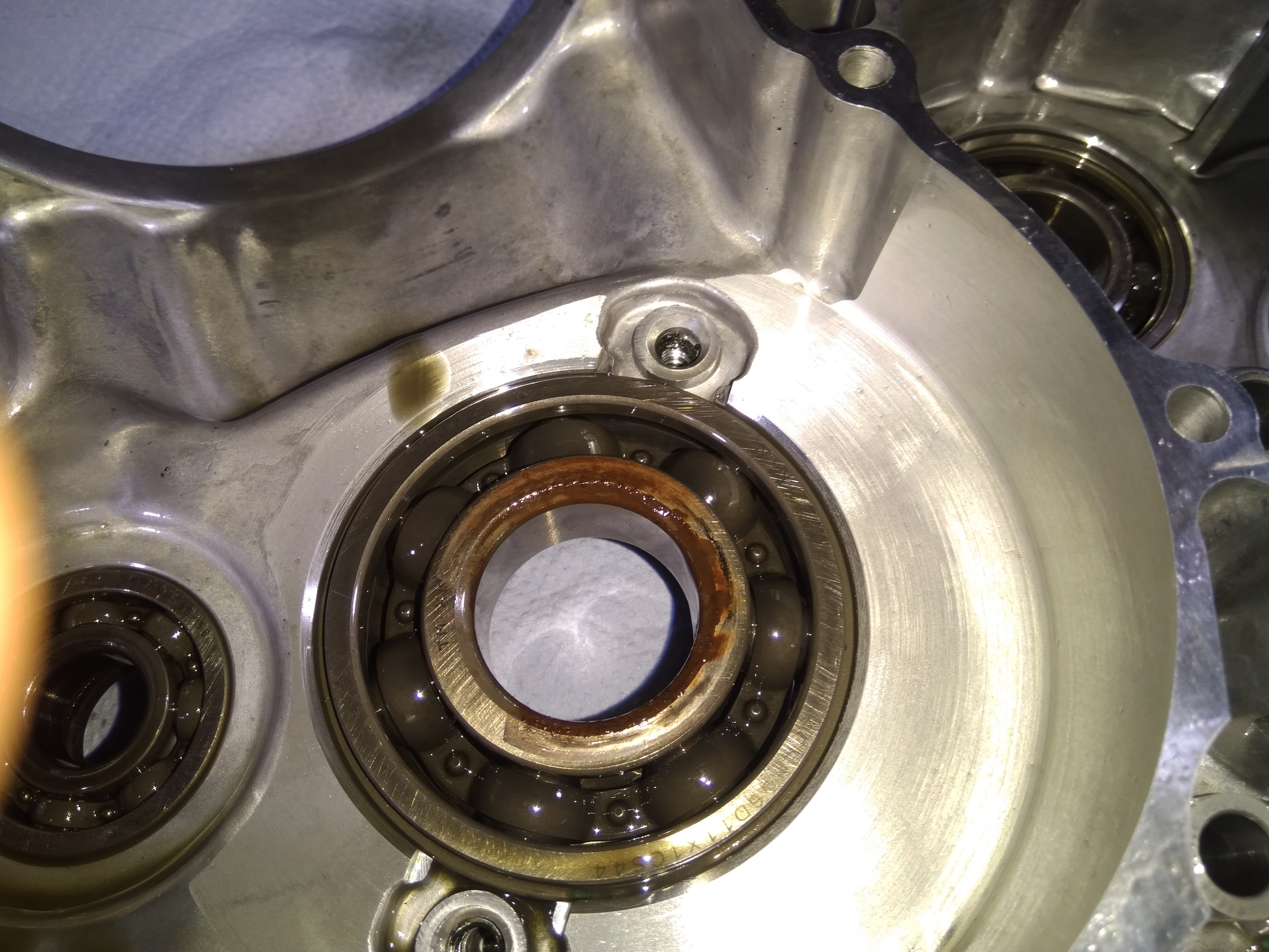

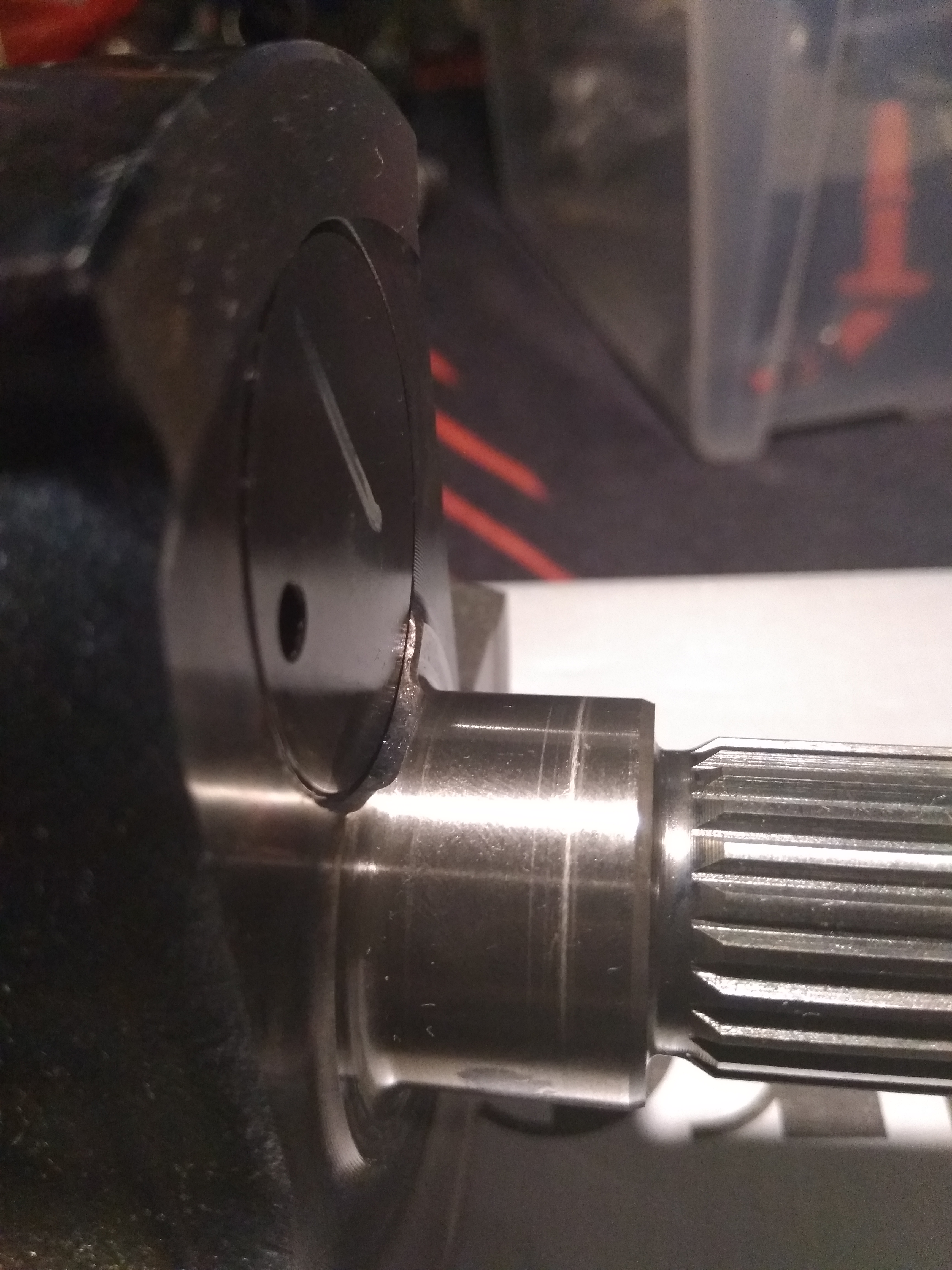

kab-pro 93 Report post Posted March 14, 2019 And now pay attention to crankshafts necks. Roller side itself doesn't much surprise excluding huge wear. In video you can hear knocking, it describe how big this wear is. By the way knock test was done with oil film on parts. But ball bearing (right side) seat place looks very interesting. Didn't seen such meltdown before and this makes me wondering, what was the reason. 1 Quote Share this post Link to post Share on other sites

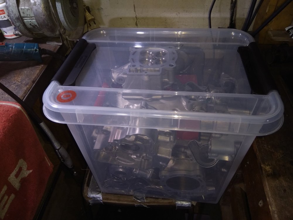

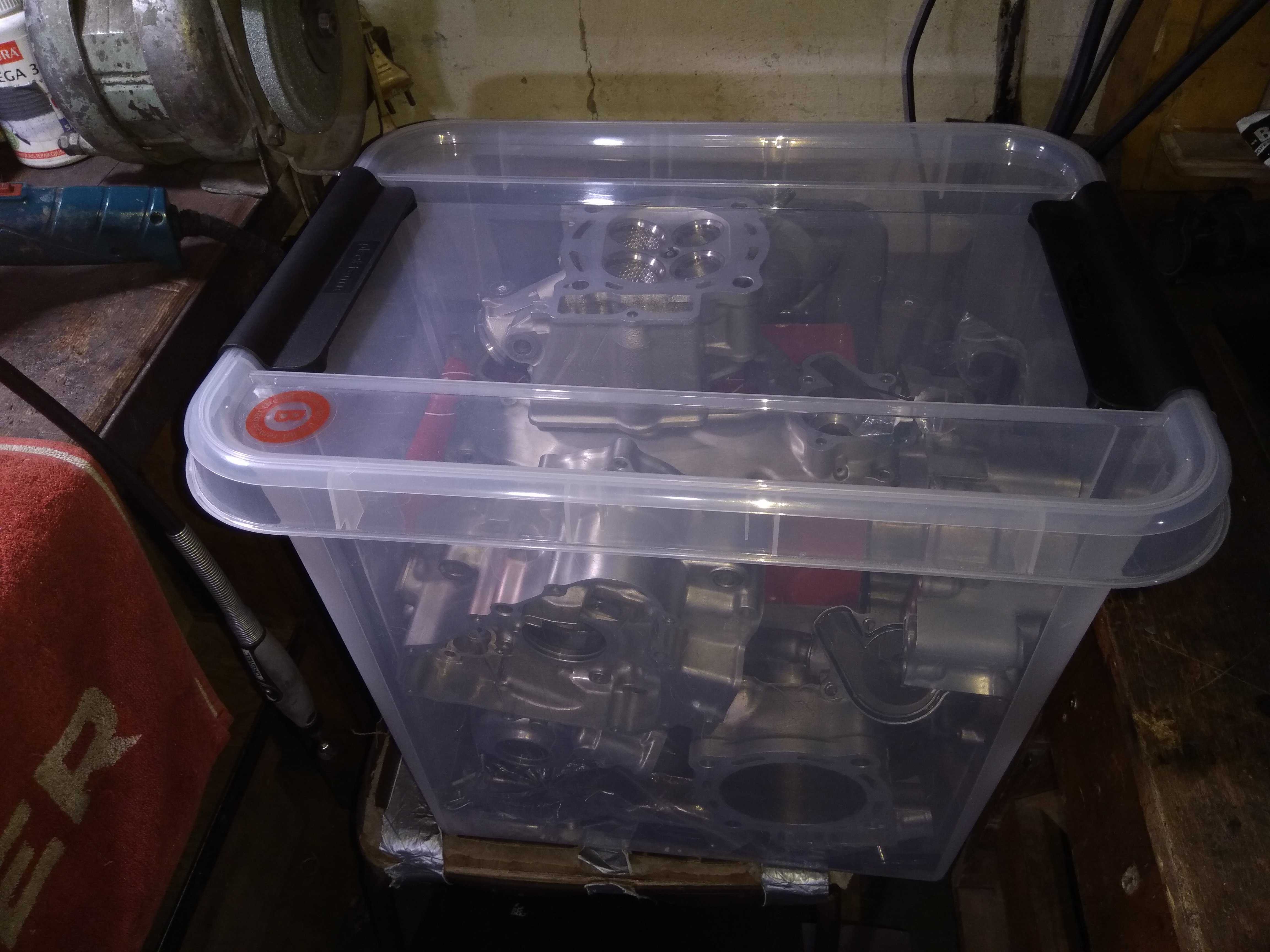

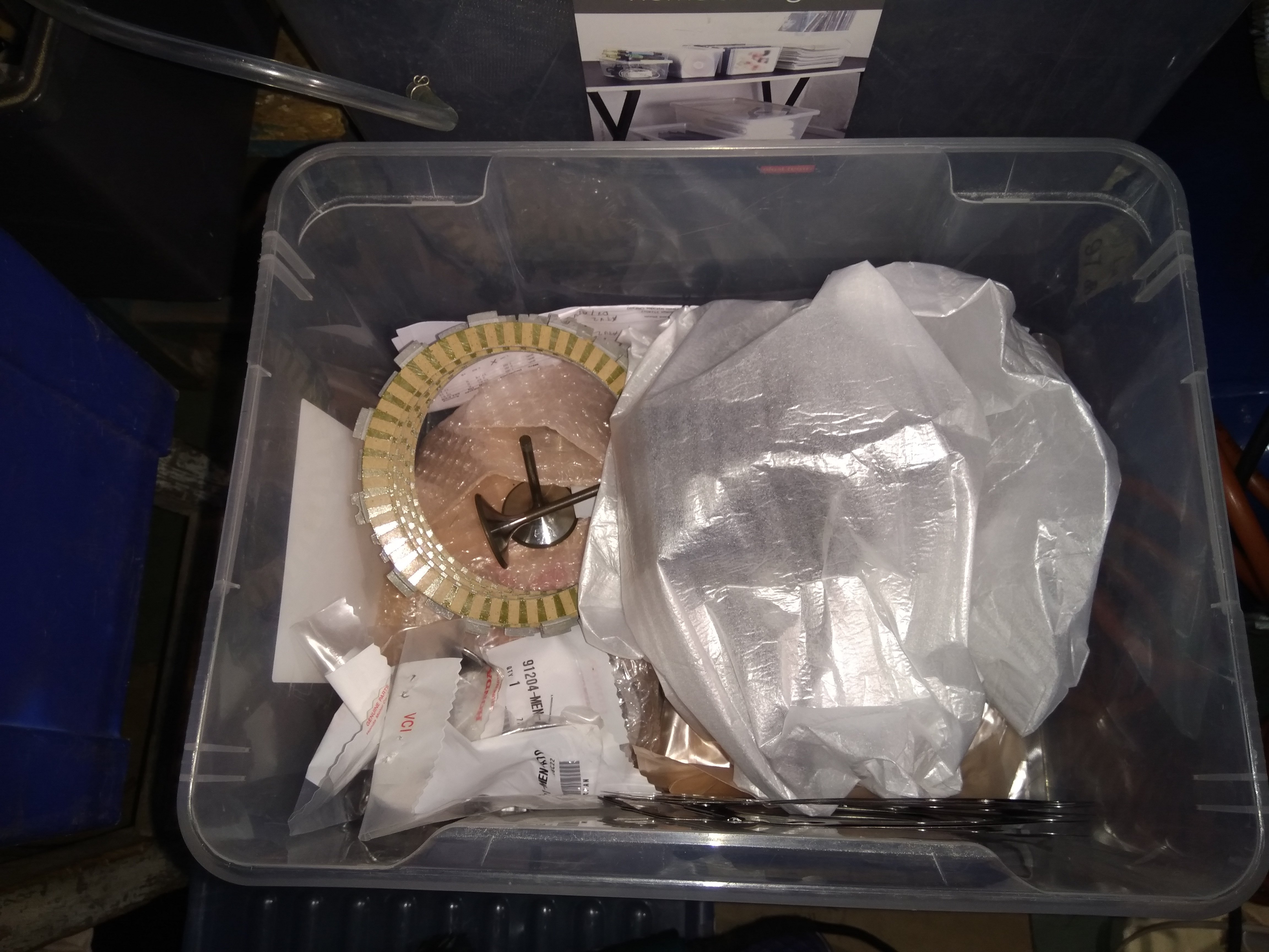

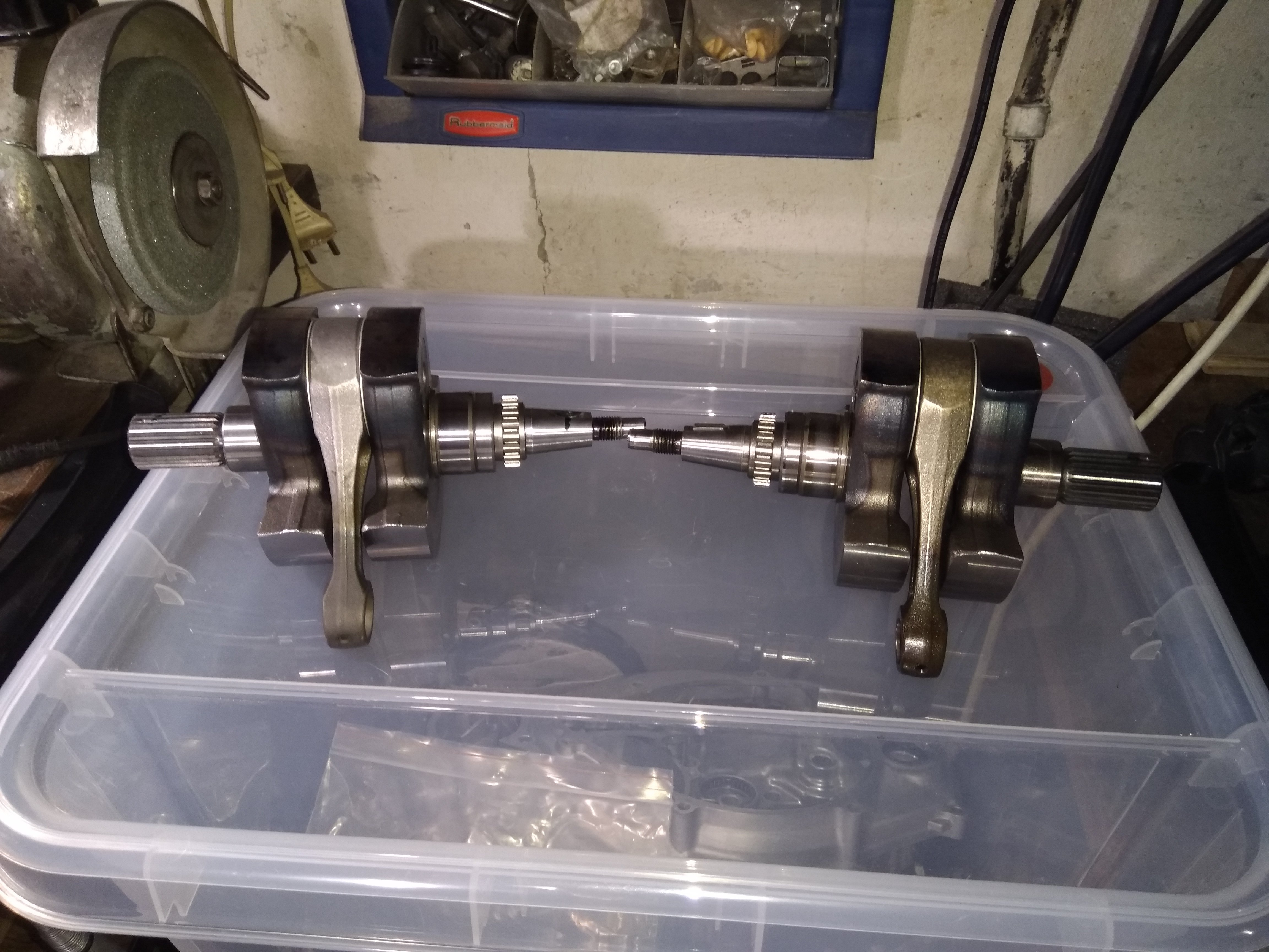

kab-pro 93 Report post Posted March 27, 2019 Treasure box. And Work bin. 3 Quote Share this post Link to post Share on other sites
F41TH 171 Report post Posted March 27, 2019 about the ball bearing seat: https://de.wikipedia.org/wiki/Passungsrost Quote Share this post Link to post Share on other sites
kab-pro 93 Report post Posted March 30, 2019 Oem crank halves casing and processing quality visually could be better. 1 Quote Share this post Link to post Share on other sites
Guest Connader Report post Posted March 30, 2019 Hi Andis, the new is also OEM or aftermarket? Color of Conrod looks slighty lighter.....!?! Quote Share this post Link to post Share on other sites
kab-pro 93 Report post Posted March 31, 2019 vor 16 Stunden schrieb Connader: Hi Andis, the new is also OEM or aftermarket? Color of Conrod looks slighty lighter.....!?! Both are OEM. Right one has some history. Unfortunately 17 + doesn't have aftermarkets jet, but as the new one OEM costs 260$ only this isn't an issue at all. Quote Share this post Link to post Share on other sites
